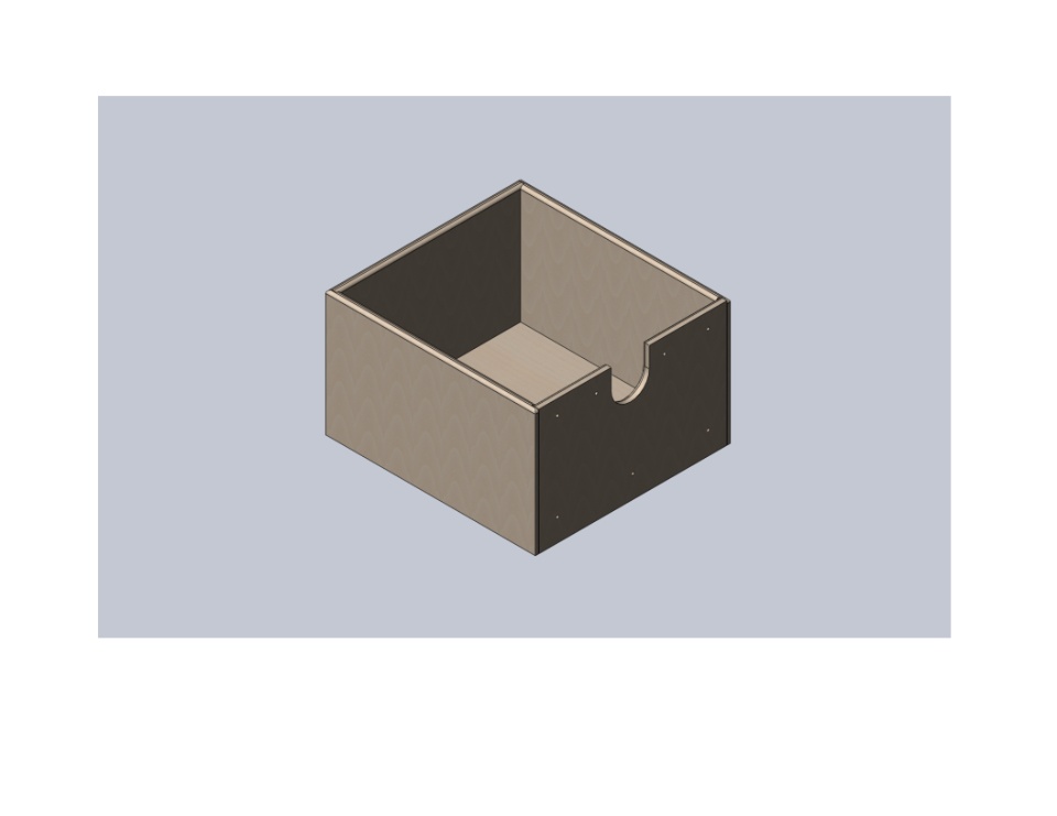

Is there a way to breakout the parts of an assembly and lay them flat on one plane? See picture of drawer box assembly.
Using the explode feature moves the parts out, but not flat. What I am trying to do is get the parts into a dxf format to cnc program in Mastercam.

you have a couple of options, but nothing automatic that i am aware of.
1) make a config with the "real" mates suppressed, and mate everthing to a plane.
2) use multiple views with displaystates or configs to only show one part at a time and arrange the views on the sheet.

Thanks Jeremy. It seems an explode feature with the flexibility to lay parts flat on one plane would be nice. This drawer box is only one sub assembly of my larger assembly, so either way will take a while to accomplish.

Just create a new assembly. Insert your parts in the new helper assembly and mate as needed for your flat layout.
That is what we do to create material nests for laser, water jet, routing, etc.
