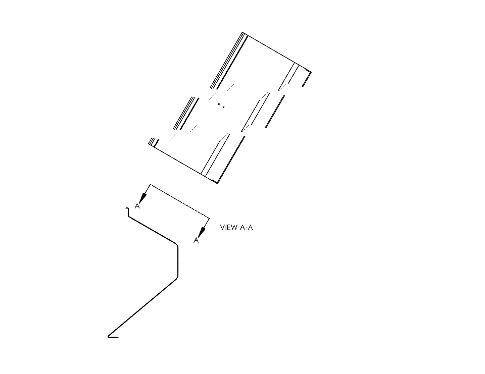

Does anyone else find it strange that you can only add horizontal or vertical breaks to an auxiliary view? These views typically take up a ton of space, and adding horizontal or vertical breaks makes a real mess of the view. It would seem logical that Solidworks would allow you to create a break line perpendicular or parallel with the orientation of the auxiliary view. Or does it already do that and I just don't know how to do it?

Breaks can only be horizontal or vertical for any type of view, not just auxiliary.

Seems like it should be a minor change, but judging by the glitches that SW already has with broken views, (and has had for years, that never get fixed) it might not be so easy. Maybe that's why they haven't implemented such a feature already.

One way to get around this is to use "Crop View" on the "View Layout" tab.
