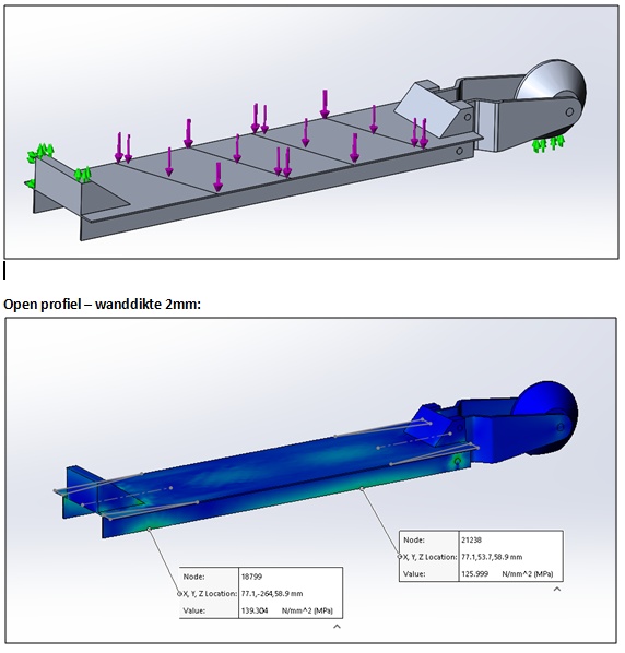

Hello all,
I have a small question. In the appendix, there's a picture of the frame of an electric scooter (only the bottom part). I have used roller BC's as shown but when I take a look at the max. tensions, they are not quite situated in the middle (which a beam will do). I have tried certain alternatives but none help. Any ideas on how to simulate it properly?
Thanks in advance,
Kind regards.

SK 2017-02-14 Best Answer
Use symmetry BC and model half if the model, if applicable.
