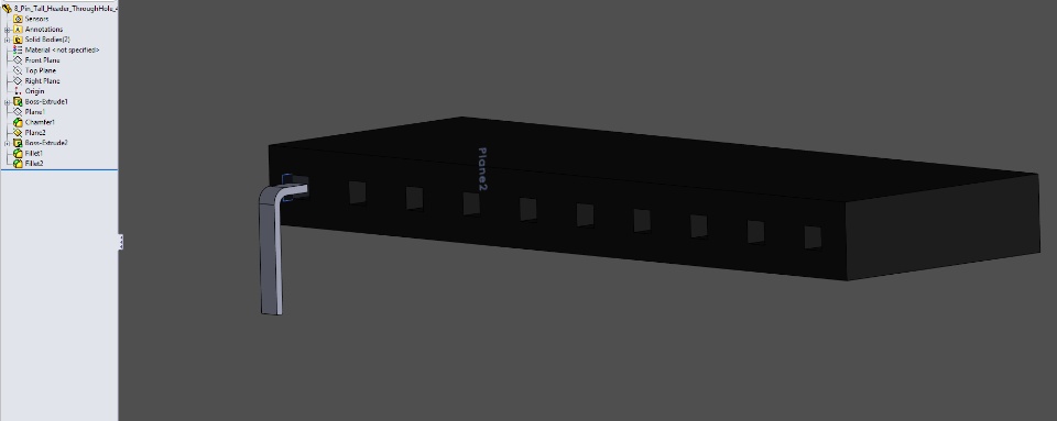

I have a simple part.  It is a pin for a through hole.  I need it to be on a 90 degree.  I make the pin then add the fillets and try and do a linear pattern it shows them in preview and allows the pattern but they are not there.

you probably selected the features - delete the pattern, and remake it but select the body instead.

You need to use body option in the pattern. Check a similar video here:https://forum.solidworks.com/message/390170#390170

Yes I selected the feature, just like a always do.  Not sure I understand by selecting the body.   Its asking for the features to select.

its because the lead was a separate body from the main part (connector?) a feature pattern will add geometry to the currrent body, but since with the spacing you wanted for the leads would not have connectoed them to the first lead, the feature pattern did nothing. the body pattern makes copies of the full body and does not care if the touch anything else.
