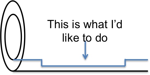

New to this but eager to learn. I have created a simple cylinder and I want to create a second “deeper” bore for part of the cylinder but am not sure how to achieve.
Any help or guidance would help and I’ve added a drawing of what I mea if the above was slightly confusing.

make a revolved part with the shape you want or revolved cut or offset a plane at one of the start of the step and extrude a cut of a circle the distance you need.
anytime you have parts like this use revolves first and extrudes last

There are a couple of ways to create the cut you want
Option 1 is to do a revolved cut
Option 2 is to create the cut using the revolved boss / base feature
Option 3 is to create a plane offset from the end of your cylinder where you want the cut to start then draw a sketch of a circle on this plane the diameter of the cut you want and then do a cut extrude, a similar way is to sketch the circle on the end face of the cylinder and then doing the cut extrude use the offset from plane feature to create the cut where you want it.

Picture a shaft detail with O-ring grooves and other details to the shaft. A simple revolved feature could be used with everything in one sketch and works well. Now this part is copied and modified for another application. Everything is tied into the 1st sketch and whenever any changes are made, that sketch has to be edited. If a dimension is dependant on another dimensioned feature that changes things could go wrong in a hurry.
The same detail could be done with an Extruded shaft and then revolved cut features for anything else required. The revolved features could be dimensioned from one end (depending on design intent) and the length of the extrude could change without affecting the O-Ring Grooves and their position relative to the "fixed" end.

Late to the game here but I sometimes just draw the circle size of the bore on the end. Start the Extruded Cut, Offset the start of the cut From as required and define the Blind length of the cut extrude.
