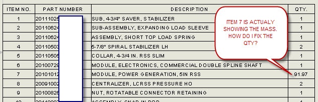

Bom Table displays Mass in Qty column. How can I fix this?
I have tried regererating the BOM Table and it didn't fix.
if i double click it takes me where i can change the property to something else but ther's no QTY property.
I tried deleting the data in the field but it just regenerates the same data.
If anyone out there can help me fix this it would be much apprieciated.

I would venture to guess that in the properties of the particular file the "BOM quantitiy" option has somehow been changed to "Weight".  If you open that file alone and look to the "Custom" tab change the value back to "none" and see if that doesn't remedy this matter for you.
Cheers.
