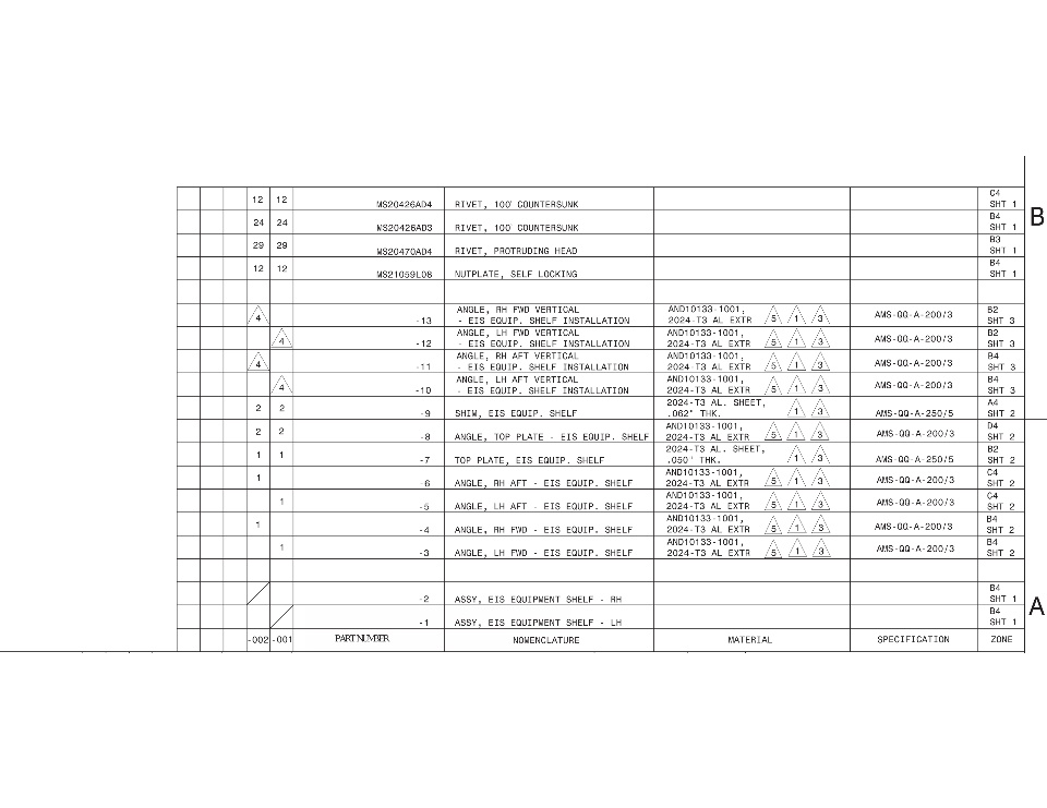

I'm trying to insert a BOM on my drawing. There are several assemblies (Left hand and right hand), plus several parts that are not in either assy. Solidworks will give me the parts only, but not assy part numbers, or top level parts only, or indented, with the part quantities in a single column. Is there a way to insert a BOM that looks like this? This is the format that our company wants, and I'd like to be able to do it like this if I can. If I use the indented option for the BOM, the common components are listed multiple times, and the BOM is much larger than it really needs to be.
