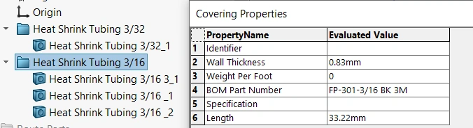

Hello! I need to display total length of isolation in BOM. I have found these properties, but I can't find "Length" property or similar when creating BOM of harness. How to show it in BOM so it will be connected to property "Length" on the image?
These are likely cut list properties. Enable the "detailed cut list properties" option in your BOM and you'll get access to them. Could also make a file property referencing the cut list property, then call that up in your BOM.

If it is an assembly, use the detailed cut list properties option when creating the BOM.
