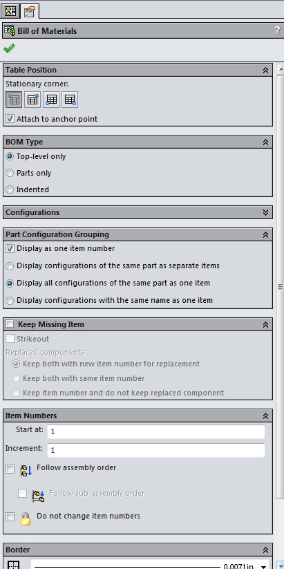

I have an assembly with multiple configurations.  On the drawing I have separate BOM's for each configuration (separate pages).  What settings are required to have the same Item Numbers for the same parts in each BOM?  ie.  Part X is Item number 3 in each BOM.
Note: I tried the following settings on the Bill of Materials PropertyManager (see image) under the Part Configuration Grouping:

Here is one idea. Make a single BOM and expand the Configurations setting and select all of the configs that you want to use. This will put all of the parts from all of the configs into one table. Then copy that BOM to each sheet and hide the columns for all configs except the one you want to show. The rows for the parts that aren't used in that configuration will show a "-" for the qty, so you can manually hide those rows.

Thanks Jamil!  I did notice that the BOM came out correct if all configurations were listed on it.  I'll give this a try and let you know if it works out.
