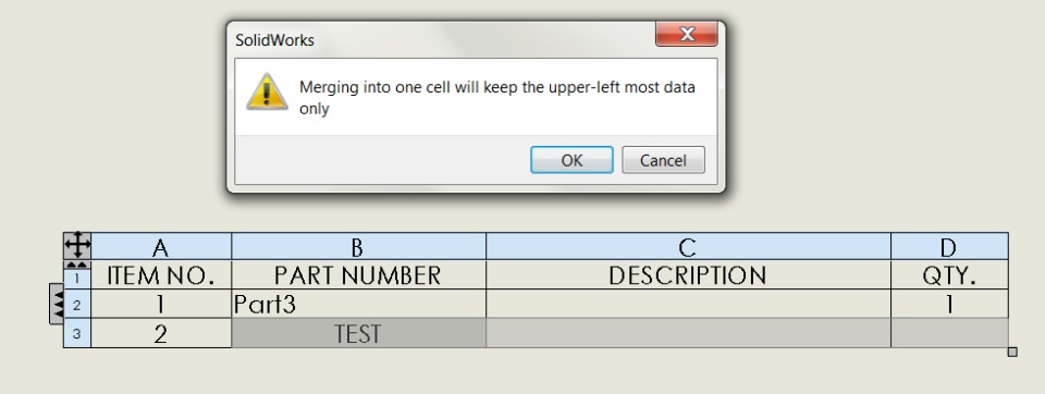

I`m using the TableAnnotation::set_Text to insert a string on a BOM Cell.
Then use the TableAnnotation::MergeCells to merge certain cells on the top of the BOM so it should look like a header.

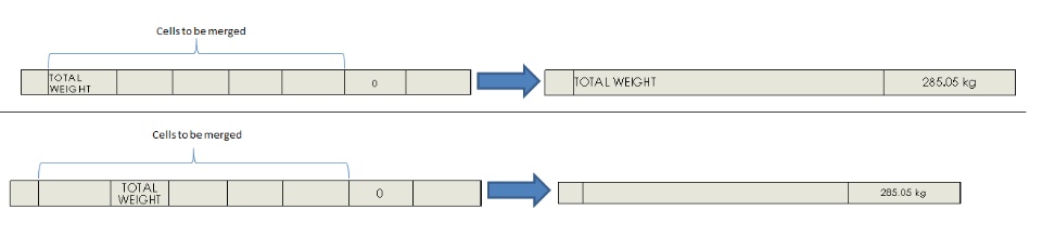

I noticed that if the string is not inserted on the 1st cell, then merged it to the other cells with the same row, the string disappears during ModelDoc2::EditRebuild3.
Example:
Aside from not using the EditRebuild3 funciton, is there a way to prevent this from happening?
