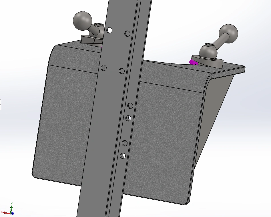

Hey everybody!

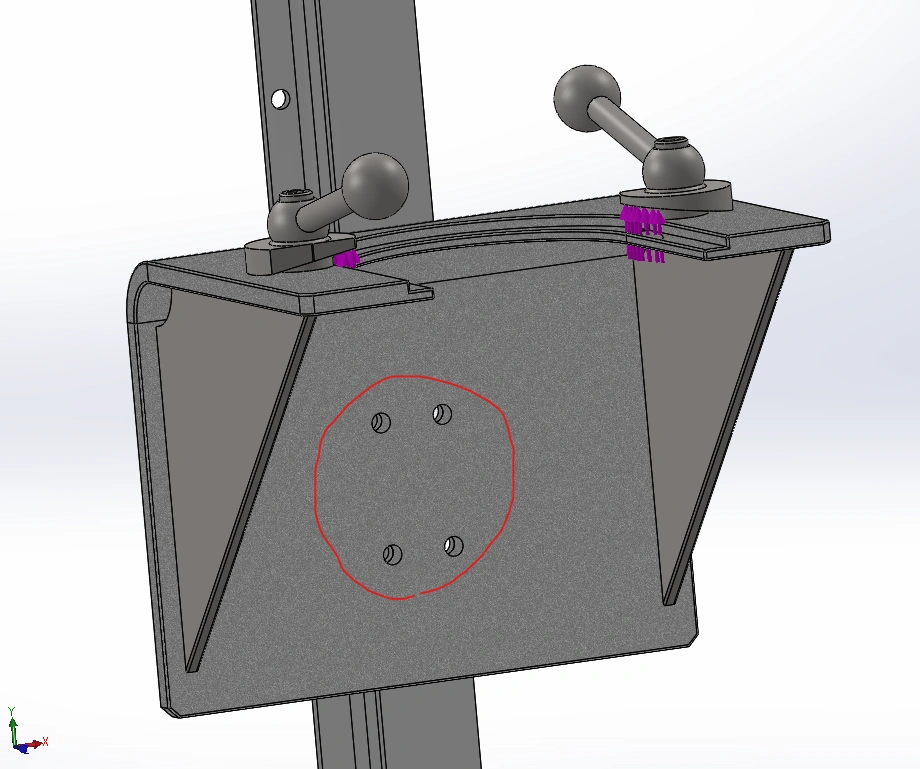

I'm currently trying to create a simulation of an assembly in Solidworks, and I'm having trouble finding a way to simulate two parts being bolted together (Bolt and nut) — I'm not interested in simulating the stresses in the bolt itself. I'm mainly interested in observing the deformation of the overall assembly, by making sure the connections and fixtures are correct. Currently the face that is touching the IPE beam face is bonded to it, with a global interaction, which isn't the best way to go about making it realistic.
So my question is, how do I make a bolt connection between the two parts, without having to use the buildin bolt connectors or simulation the bolt itself as a solid?
