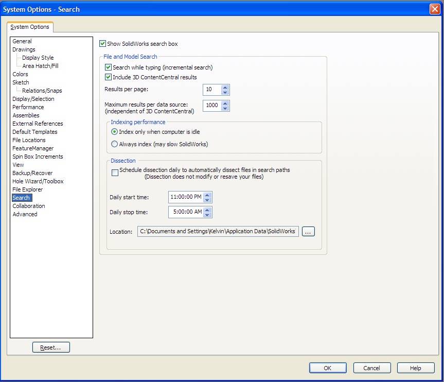

The bo_dump.txt file may be connected with the SolidWorks Back Office.
Do you have the Dissection function enabled?
Regretably I am not familiar with the Back Office software. I am currently running SW 2011 x64 Edition SP02 on the machine I have access to. The additonal products installed are SW Explorer/Workgroup PDM 2011 SP 2.0 and SW Flow Simulation 2011 SP2.0.
Dissection is a standard function of all SW editions. It is not an additional or add-on product.
You can check if it is active at Tools > Options > System Options > Search

It is logging back office functions in SolidWorks.
Cheers,
Anna
After reviewing the disection settings on the PC's affected to the PC's unaffected, I have verified that the service is active. I have disabled the service on those affected and would like to give it a day or so to verify the files stop being created.
