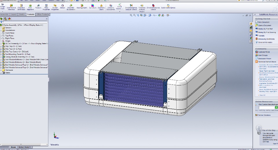

When I open some of my assemblies my compnents automatically switch to lightweight/blue feather icon. Why is this and can I stop it from happening in the future. It's a real annoyance clicking the 'set to resolve'.
Uncheck the option shown in the pic and you should be good to go.
Thanks Don.
