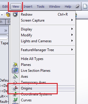

As I an making drawings of my first assemblies after returning to SW I see all these blue icons that look like the part center point with the arrows showing the axis directions all over my drawings. It would appear there is one for each of part in the assembly, I don't remember them from before. How do i turn them off?

They are file origins. Turn them off under View menu.

Those are not COG's, they are the part & assy origins. Go to View and deselect the Origins option.
A keyboard shortcut can also be assigned to toggle the Origin visibility.

Thank you guys, I will get that this evening. Is there a system setting to deselect them as standard?

That setting would be in your Drawing Template. Open it up and turn off the View > Origins. That way all new drawings will have it turned off. Existing drawings - you'll have to manually do this.
