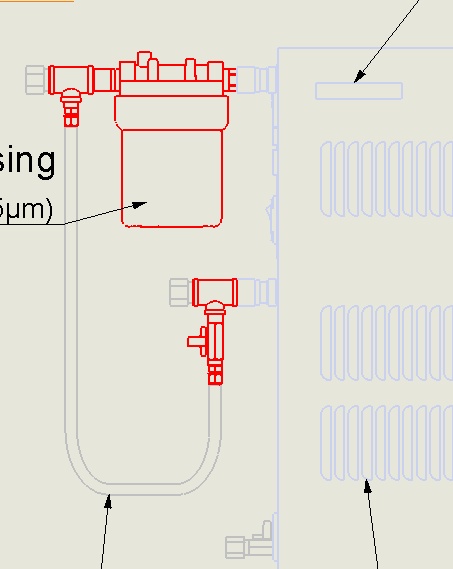

Hello,
I would like to know how I can fixed my standard views back to black and white. When adding some dimensions to my views,  all of the sudden the views changed color to a light blue and red (See picture below).
I have tried to re-inserted the model again to regenerated the views and changed the display style, but they have not been able to bring the standard views back.
It appears to me that the views are not properly generated, so any assistance will be greatly appreciate.

Check this option on your Line Format toolbar.
If that isn't it, and after thinking about it it probably isn't, see if this option is selected.
comment imagecomment imagecomment imagecomment image

Glenn,
The model color for HLR/HLV in drawings was selected. Once I made the changes the views went back to normal.
I appreciate your assistance in this matter.
