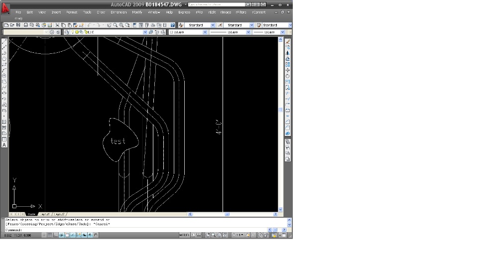

I have added an example from AutoCad to clarify.
The only way might be to create a block having a text and a boundary (with hatch) and then insert that as required. This will block out the view.
