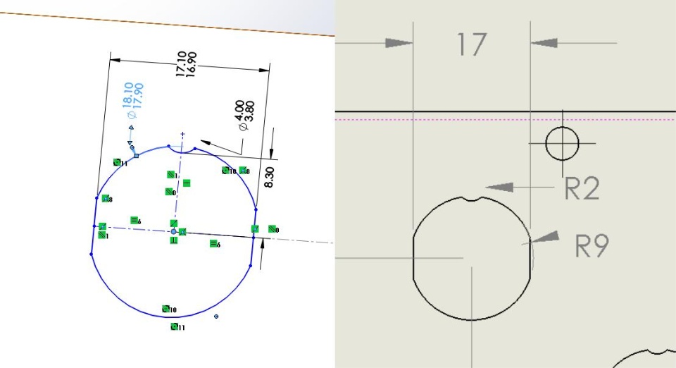

I have a question I can't seem to find the answer to. I have set a limit dimension in a sketch block. I used the block for an extrude cut (connector cut out). I am now making a drawing for machining, I would like SW to display the Limit Dimension tolerance I have already set up in the block. Is this possible? Or do I have to do the leg work of re-inserting the limit dimensions in the drawing?

   While doing the drawing click on the Annotation tab and then click Model Items.  When you then click on the drawing view it should import the sketch dimensions into the drawing.

Thank you very much. That worked perfectly!
