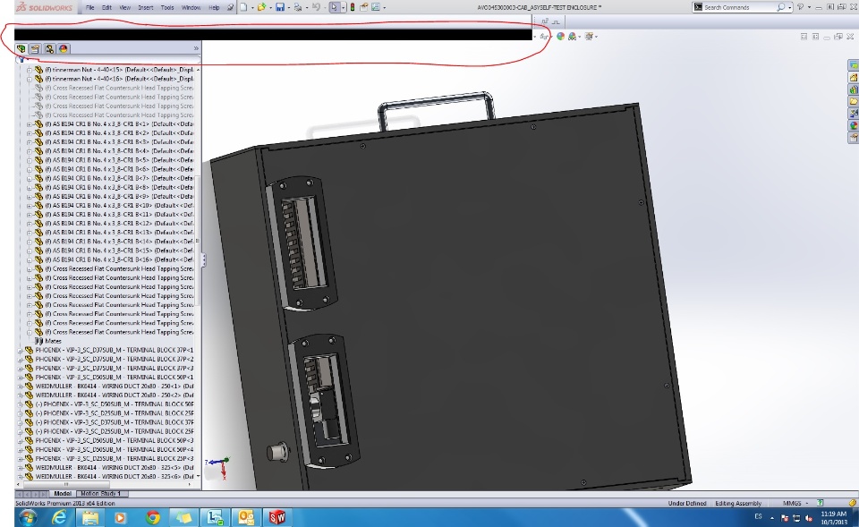

I am using solidworks version 2013, sometimes I have a black bar, it  appear in the menu options, I can not see the options very well. I have been installed the SP4, but I still have the problem. I attach the image with the problem.

Welcome to the forum.  I'm not a hardware expert by any stretch of the imagination, but that may be a graphics card problem.  Can you post your system specs?  I'm sure someone can look and tell you if it's likely to be a graphics card problem or something else.

Run the SolidWorks Rx and see what it reports.  This is usually an indication of a graphics card issue.
http://help.solidworks.com/2013/English/SolidWorks/sldworks/t_solidworks_rx.htm
Do you have an approved graphics card and driver for your version of SolidWorks?
http://www.solidworks.com/sw/videocardtesting.html

Did you run the SolidWorks Rx tool?
SF
SF 2013-10-11
Yes, I Run the SolidWorks Rx Tool, the diagnostic looks ok
SF
SF 2013-10-11
I installed the drive for the graphics card and SolidWorks version.
JW
JW 2013-10-11
Hi Maria,
Your CommandManager looks empty, so maybe it is related to that. Try turning off the CommandManager and see if the problem goes away. If so, then you know it is related. If so, you need to figure out why it is empty. Go to Customize and see if all the tabs are set to hidden for starters. Maybe try dragging the CommandManager off so it is floating and put it back to the docked position. I haven't seen this before so I'm just giving some things to try to troubleshoot.
