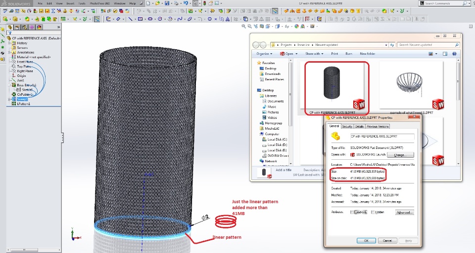

I have a problem: my file(s) have been way too big. one file got the "record" of 103MB.
I made 2 simple patterns (circular pattern, linear pattern). When I made the circular pattern, the file was of normal size (about 680KB). The linear pattern itself added like 41MB(Megas!) to the file.
does it make sense?? The circular pattern had 100 instances (and didn't cause a huge file), while the linear pattern, which was 50 instances, added more than 41 Mega Bytes.
Any way to make the same with less megabytes?

How many instances is in circular pattern?
Use revolve, not sweep, make circular and linear pattern for bodies (not for features) and combine bodies at the end or better to don`t combine them at all.
I`ve got 1.265 MB 50x50 instances

Thank you very much.
Tried that, still huge file. Don't know why.
Take care. Sometimes I need to close the software since it's wtill working on rebuilding.

upload it without patterns
IF
IF 2018-01-14
100x50 takes 1.42MB
Reorder features: make both patterns to be last

Thanks very much For.
When I get home, I'll send you the file with the patterns suppressed, I noticed this way it's a small file(but I need them unsuppressed anyways in the end). Will try reorder.

Thanks so much Igor!
It did help. I reordered them. I thought I had some problem/bug with the software. I can send you the real file now, it's 110 instances for the circular pattern and 50 for the linear ones. The file now is 2.16 MB. When it saved it much faster (like 100 times faster) I knew it might be OK and it was OK.

send it as it was before reordering

Here it is my friend.
I supressed the linear pattern so I can send it to you, the original file. When you unsupress and save it you'll see the huge size.

It`s not a bug, your problem was in sweeping with merging result option checked

Hi Igor,
Thanks, I see. So it basically patterned more than one simple feature due to the merging and thus the huge file.
You've been very helpful and I appreciate your help,
