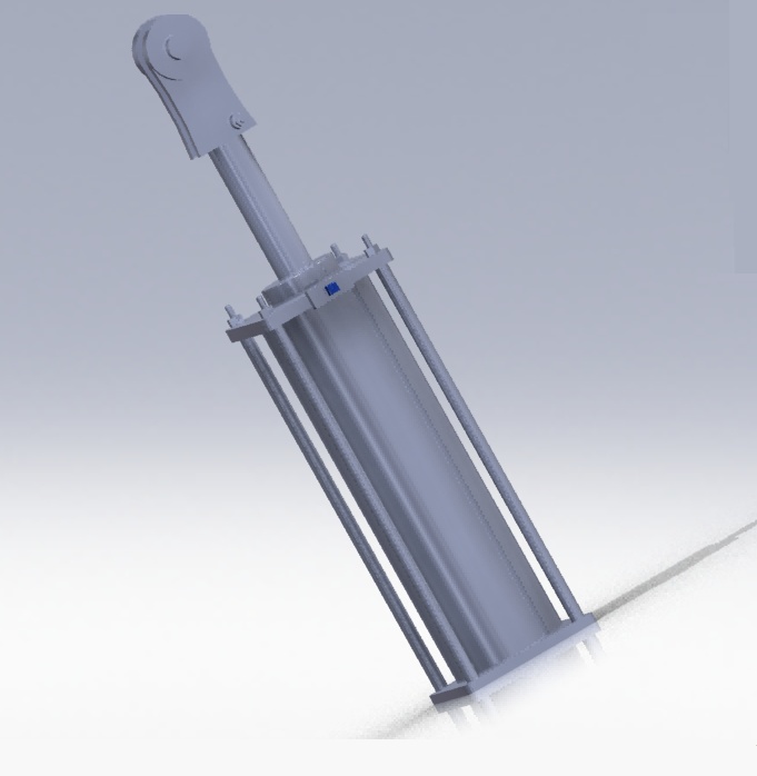

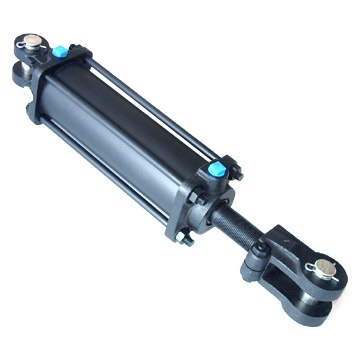

Hi i am making a hydraulic cylinder for my college project and i need to make a sort of realistic render using photoworks, i have currently modeled this model attatched but i want to achieve this type of realness, materials, colours and overall so the cylinder looks real itself, but from my render the rendering looks rough etc, how can i achieve this please, i want the outcome to look fairly similar to this other image attatched.
(I know it wont be extremely realistic but i want it better than what i am rendering now quality wise)

Adam, are you applying the material, texture, appearances, etc. properly. From the render picture, it seems you are using a default plastic material and hence is the result. Try your hands on the rendering tutorial under Help > SW Tutorials.

Open up the Appearances task pane on the right of the screen (looks like a beach ball).
Pick some realistic materials and drag them over to various components in your assembly - mostly assign them to the entire part.
You should be able to find knurled textures, etc. for various parts of your model.
As a tip, also create some very small cosmetic fillets on most/all edges of all parts to increase the realism (no such thing as a perfectly sharp edge in reality).
If you're not having much luck getting good results out of Photoworks after doing this, follow Deepak's advice and open the part in Photoview 360 (can be found under SolidWorks in your Start menu).
