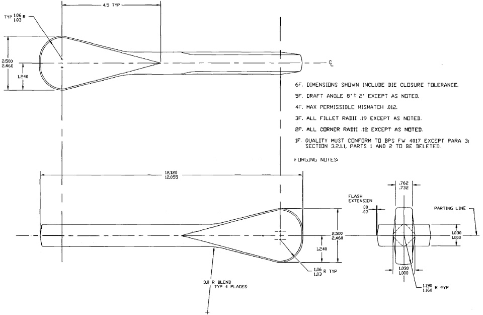

I wanted to get some pointers on the best way to tackle this part.  I was thinking about doing a revolve then some cuts but not quite sure how to tackle it.
Any help would be greatly appreciated!!!

Hi Chris,
I would probably do the same, or extrude the half length, it's just the more I look at this drawing , the less I see...
I think that there are some dims and lines missing.
Apart from that, have fun.
Adrian.

Sorry, I updated the picture with the notes.

Ok, I see it now.
I would probably model the "top" half then mirror.
Extrude the form with the draft angle, cut and trim, fillet, etc.

If this part didn't have any draft angles it would be a lot easier to do.  I can make the part that has the draft angle on the sides (horizontal part in side view) but I cannot figure out how to extrude the other one with the draft on the top and bottom of the tear-drop shop (vertical part in side view).  Can anyone help me do this?

Yes, it would be easier if there a were a couple more dimensions but... It can be done a different way and I think this is really close.

  That is super close.  The only thing I see that is incorrect is the draft is wrong on the one part (see what it should be below in green)

Didn't see that small view in the drawing.... But here it is and now it's time for lunch!  I'll let you finish the fillets!

Thanks a million Don!!!  I added the fillets and it looks beautiful.  I went through how you did it step by step and it was very helpful.

I saw something completely different! But I can make anything more complex than it needs to be!

Sorry, I have been on holiday. I have quickly rotated and knitted to solid to give you two ends but both ends have the vertical draft (you would need to make the flat parallel faces).
I am not sure if the dimensions will work out as per your drawing - the sketches might need modifying to get closer. I am not sure I would model a design like this, but designing from scratch is different to copying existing and given data.
See what you think.
