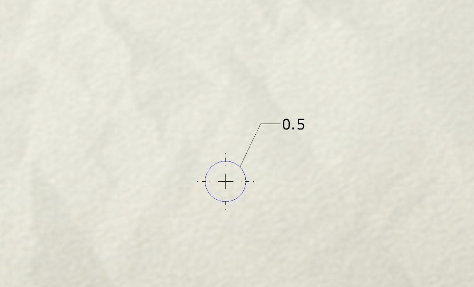

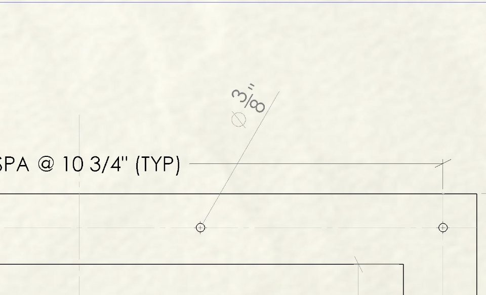

We are trying to call out hole dimensions with bent leaders.Does any one know if this can be done with SolidWorks? I amattaching two pics. The first one is how we would like it to looklike. The second one is how it looks so far.SolidworksDrawings And Detailing

are you trying to use ANSI standards? If so, your first stepshould be to select ANSI from the "overall drafting standard", thento any company customizations from there.
After that you can go to Tools>Options>DocumentProperties>Annotations>Notes>Leader display and then clickon the Bent radial button.
SF
SF 2009-03-03
Where can I find overall drafting standard?
SF
SF 2009-03-03
Tools->Options->Document Properties and it's in theDetailing menu
JH
JH 2009-03-03
Right click the top of your tree and select DrawingProperties or go to Tools/Options and select the DocumentProperties tab.
Its the very first thing there: Drafting standard
SF
SF 2009-03-04
Charles, David and Jeff. Thanks a ton. That worked.
