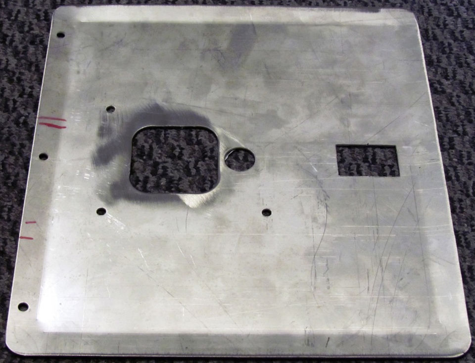

bends that cross another bend
I would like to create a sheet metal part similar to the one in the attached picture. All four sides are bent up a little about 1/2" from edge to create a 1/8" raised edge. I'm not sure how to create it in SW without adding corner reliefs. Any ideas how this could be done in sheet metal design?

You could create a forming tool for this.

Thanks for the quick response, Bernie. I had not thought of form tools. I may try that.

You could also try a Swept Flange, though you will likely need a small radius at each corner.
The part looks very similar to some parts that I have made with the swept flange.
