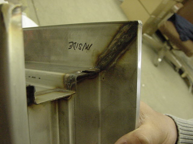

Hello everyone,
I need help creating some parts in Solid works. I am trying torecreate the attached picture in solid works and I am having a verydifficult time adding the cutouts on each side of the part. Thesedrawings are for some sheet metal door frames that our sistercompany makes and I am being asked to draw all of their parts insolidworks but like I said, I am having a very difficult timeadding the cuts out. Any help will be really appreciated. Thankyou.SolidworksSheet Metal

SF 2009-05-06 Best Answer
Franklin, Just a quick follow up on my earlier comments. Ifyou do need the slots cut on the bend as you have modeled them.This will need to be done using the commands 'UNFOLD' and then youcut your slot. Then use the 'FOLD' command to refold that bend(s)you cut through. This will allow you to make the final flattenrequired for drawing format. But you cannot make your cut acrossthe bends and expect it to flatten. On another note: Me trying todefine your problem when I defined it as unifrom thickness problemwas a poor choice of words. I hope this will clarify just how youcan make your model work to get your end results.

Eduard,
Thanks for your input in my problem. I will try the fold/unfoldcommands to create the slots. However, my problem lies on theactual cuts that are on each end of the part, not the slots but the45 deg cut. I have a problem making this cuts on each end andgetting the same results as the flat sample part that we have. Ihave attached a .dxf file for your review maybe this will clarifymy problem.

Franklin,
You are trying to do to much thinking, let SW tools take the strain
Have a look at how I have done my corner notch, its just a plain45° cut but I have selectedNormal cut in the extrude.
99% of the time I will use normal cut when I am in sheetmetal.
Try it on your own part 16ga-STANDARD-F FRM Extrude 10 to see thechangeit will make to your cut-out.

MD
MD 2009-05-07
Justin,
Try switching off Normal cut on my sample part, then flatten thepart, you will have 10 beveled edges were before with Normal cutyou had a nice perpendicular edge.
Michael
Edit: In Franklin's example he would only need to use Normal cut onhis first Extrude as the rest are perpendicular to the sheetface.
