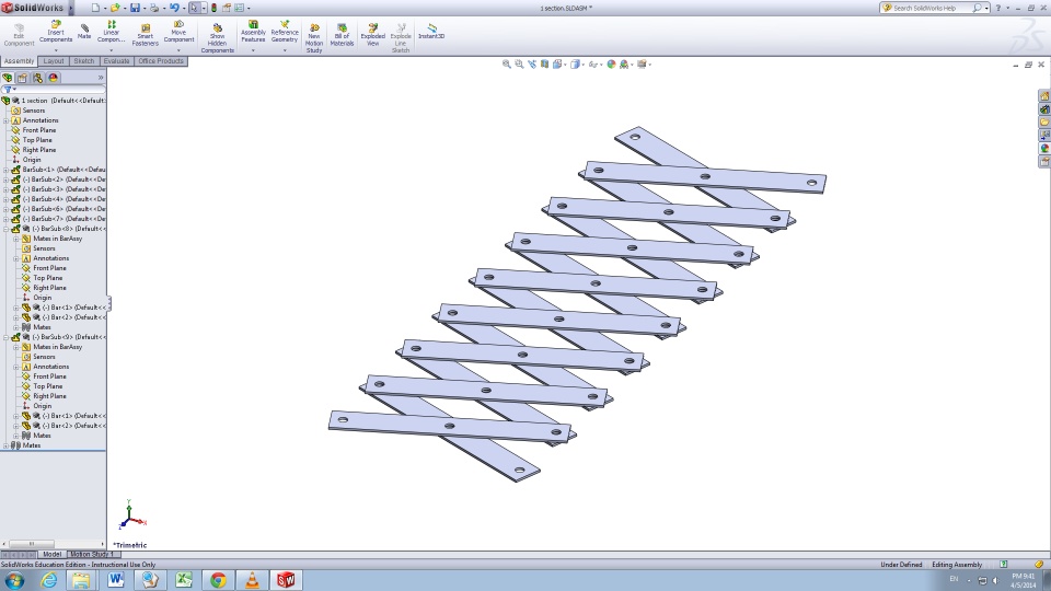

I've made a straight bar and inserted 16 bars into the assemble. Then the bars are mated together (see first attached image). They are flat. They can move like sissors in the plane.

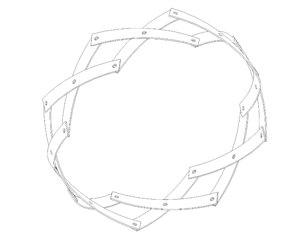

Now, I want to bend them into circular shape. I have done something like that (see the other attached image). But I mate the 16 bars in assemble first, and save it as the part format, and then use the flex feature to bend it. But the model can't be expandable and foldable, it is completely fixed. Ideally, I want to the model can expand and unexpand (compact). What I am tring to make is like medical stent. It can be deployable, the length and diameter can be changed.
Can anyone help me, please?
Thank you for your time.

SF 2014-05-04 Best Answer
Hi Bin,
Could you download the .zip file of your model using the Advanced Editor?
It will help the forum community to see what you have tried already.
