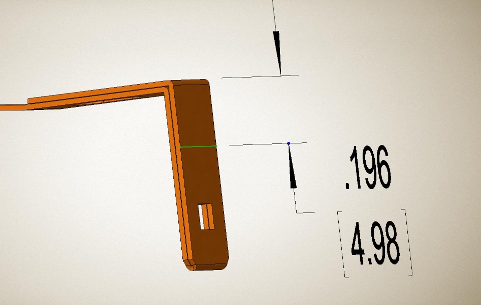

Is there a way in sheetmetal to bend a doubled over tab? This is a spade terminal contact that is bent back on itself and then bent at an angle at assembl for close quarter access to plug the wire in. I need to create a cad only configuration on this sheetmetal part to add the secondary bend for assembly and can not figure this one out.

The doubled over bend is referred to as a hem, there's a tool for it in SW. Leave at least a .001 gap between the insides or the part won't flatten.

I need to bend at the line in my photo and bend both at an angle. Can this be done?

I think you will need to use the flex or deform features to bend both layers at the same time. otherwise 2 sketched bends (one for each layer) might work with a bit of math.

I don't see why not, remember the gap rule! The tip of the outside form at the top where it ends up close to the kink, also be sure it does not touch there so they can unfold within SW. In actual practice they most likely will be bent at the same time.

Try starting with a sketched end-view with the bends already in and having a small clearance between lines. Then use the "base flange" command to create the part.

Flex kind of works, any sheetmetal creation is a nogo. hem only uses edges at this point, sketched bends will sketch and error on bends. I get a hollow solid look though.

Here is an example of what Jeff stated above.

well since you didn't like how flex turned out, here is a sample using 2 sketched bends.
