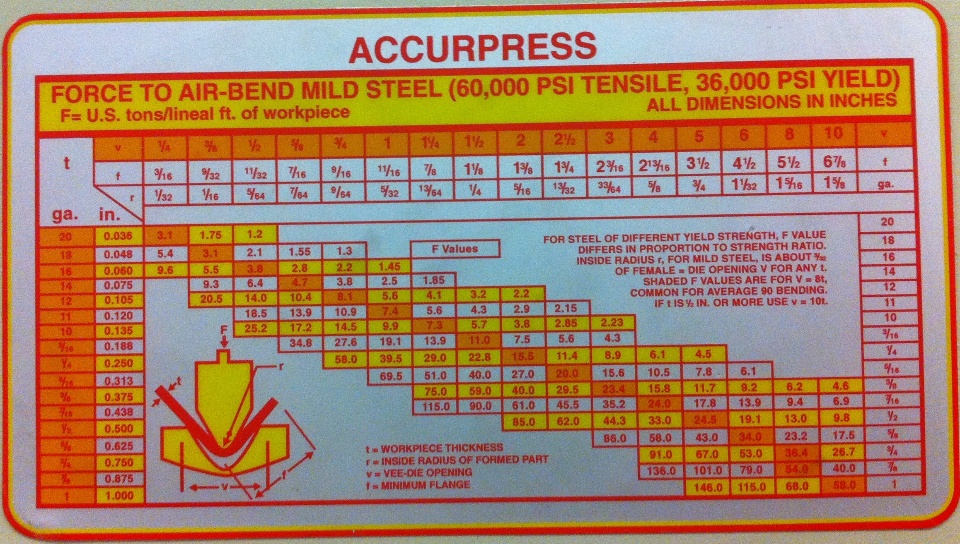

As I understand, that even with same punch I will receive different inside radiuses according to thikness of material , am I right?
On the brakepress i found this table: (if you can't see it well , I attached it)
I can't understand, if radius on this table is suggested or that radius which I will receive?
If somebody have experience with airbending, which parametrs of radius should I put to calculate my flat pattern on Solidworks?
We working on 18 gauge with 8 mm die and 20  gauge with 6 mm die. Does I need to put differnt inside radius when working with this materials- in my example, when I working with 18 gauge, 3/8 die- radius will be 1/16 and when I working with 20 gauge 1/4 die - radius will be 1/32. Or I just need to put 1mm radius and nevermind of all other parametrs as my punch is 1 mm at the end (We bought Wila tooling and all dimensions are in mm)?
