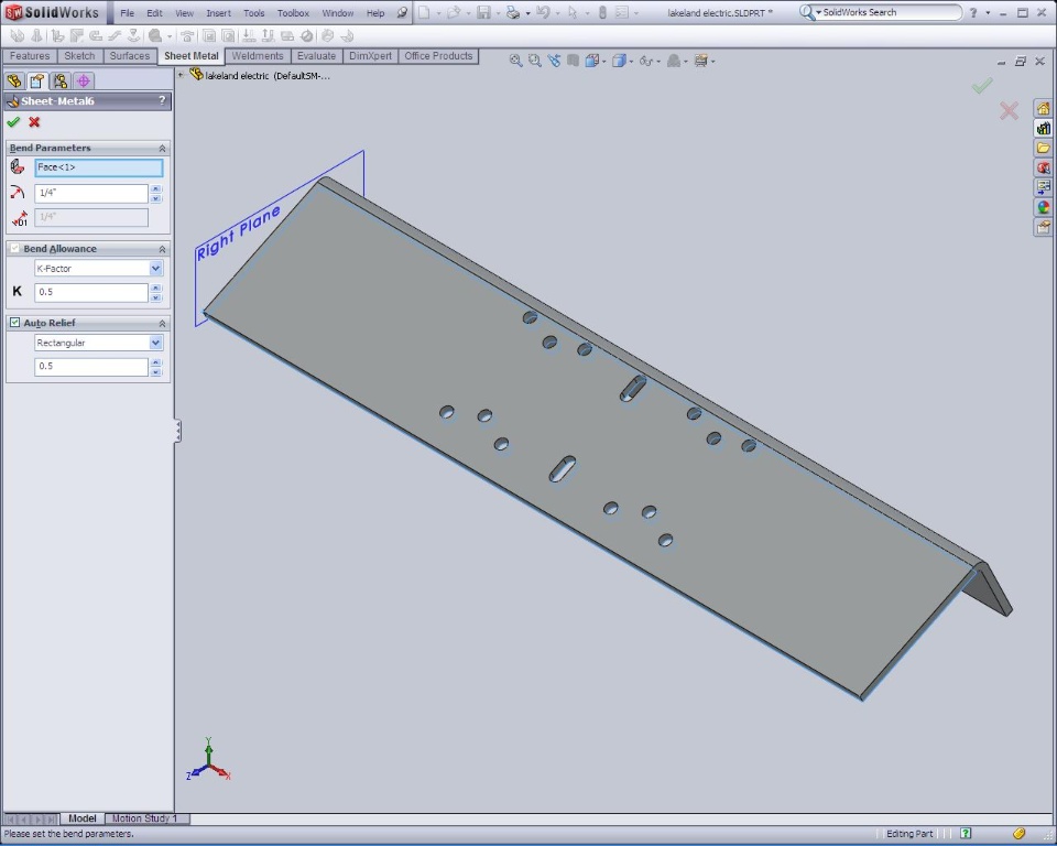

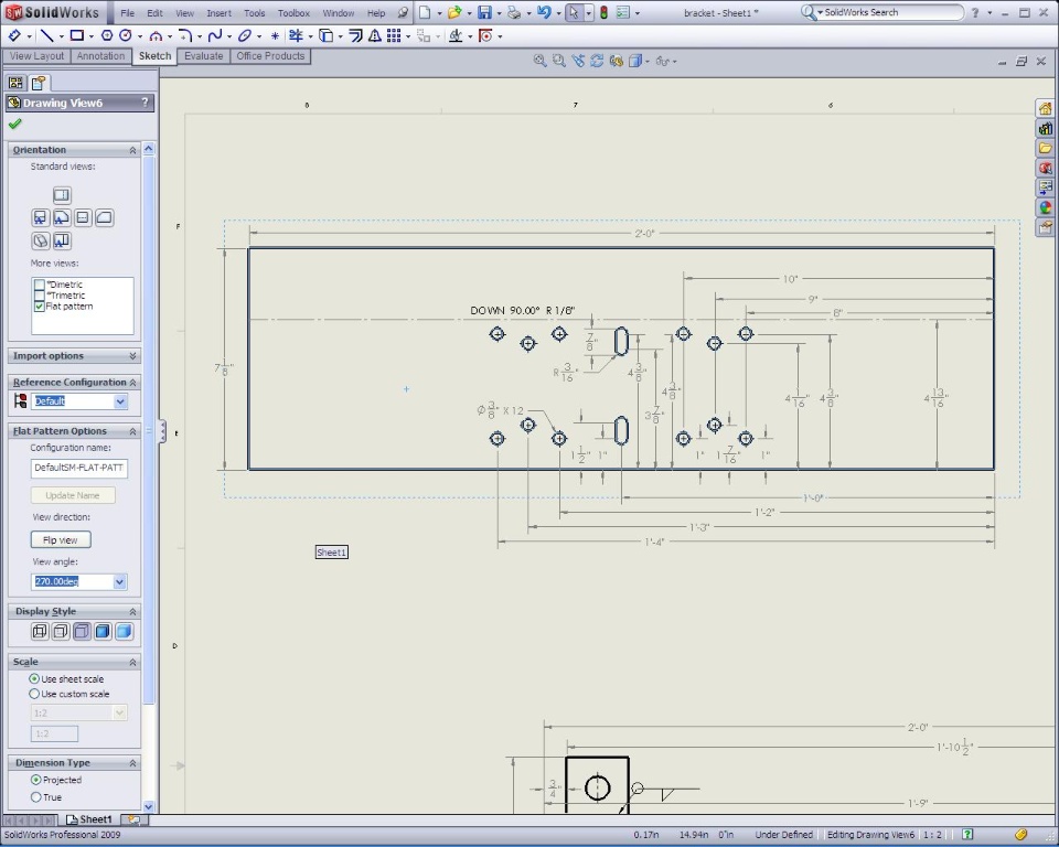

I have included two images here, maybe its just a mondaymorning question.
In my drawing i have a bend radius of 1/8" displayed.
In the part file i have a 1/4" radius specified.
I want it to show the 1/4" radius.

Do you have configurations in the file that are using twodifferent bend radii?
If so what is the configuration the flat blank view is set to? RMB> Properties on the drawing view to see which configuration isselected.

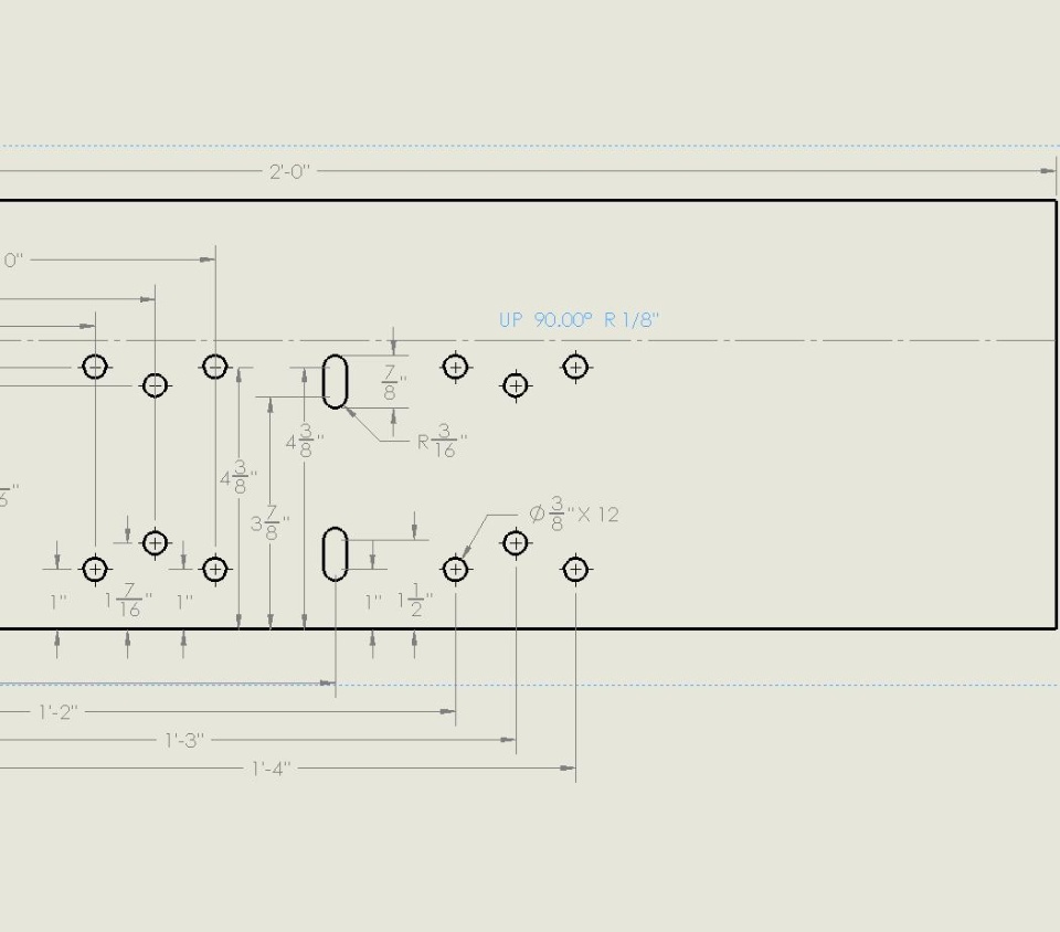

here is another image if it helps of the drawing view

I can't explain why it shows the 1/8" in the flat pattern drawing,but the reason you are not seeing the 1/4" radius as desired isbecause of the way you built the part. If you really want to modeland then insert bends, model as a sharp corner and let it put theradius in.
But you might also take a look at building it as a sheet metal partfrom the get go by starting with a base flange. For simple parts asthis, I prefer that method as it gives you better access to thebuilt-in tools.

It shows an 1/8" inside bend radius because that is what youhave modeled and defined in your first sketch and extrude feature.
You have a 1/4" thick part with a sketch defined 3/8" outside bendradius. 3/8" - 1/4" equals an 1/8" inside bend radius. TheSolidWorks flat blank is correct for what you have modeled.
Change your sketch to show a 1/2" outside bend radius and you willget the inside bend radius of 1/4" you want.

HAHA Well then, Id have to say that was a monday morningquestion. I changed the sketch to the 1/2" outside radius and itdid correct it. Thanks Everyone.
