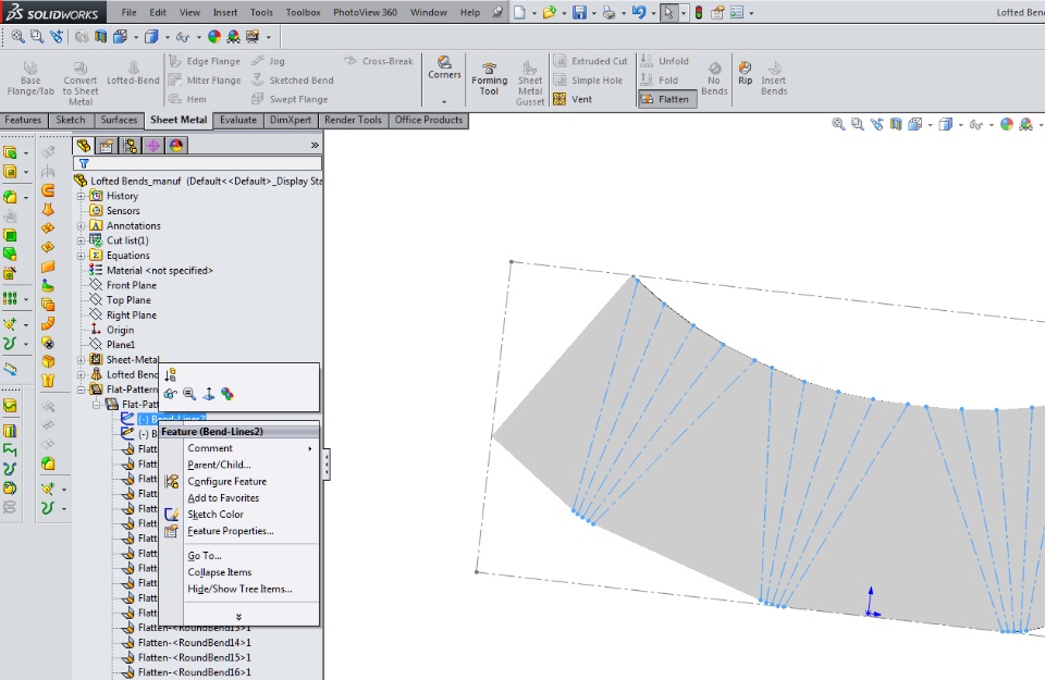

Dose any one know why i can not get the Bend property manager to show
i have SW 2014 SP3   just trying the sheet metal tools out loft sheet tool as in the SW Sheet metal training book pages  183-184 i cannot get the 'Bend deviation tool to work'
as in  the support pages dose it if so what am i doing wrong ?

    3. Right-click Flatten-1, and select Bend Deviation.The graphics area callouts display the bend deviation values for each edge. The bend deviation plane for the Bend
