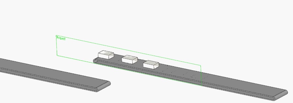

Is it possible to make belt conveyor belt move products on belt? I know that this could be done with separate linear motors, but it is so laborious for large amount of products and conveyors/conveyor speeds.
That attached simplified motion analysis assembly explains what I'm looking for.

Henri in that case you might have to model the belt converyor as a chain with multiple links. Using linear motors can be the way (as you have used in your animation) or check if path mate can helpyou.
Thanks deepak!
Once I found from this forum a chain animation called "Crab chain animation" where chain roller worked as pulling roller for all links. I was wondering if it is possible to use some same kind of trick for linear movement?
Modeling chain links feel quite laborious method also. There has to be some simple way to model belt conveyor.
