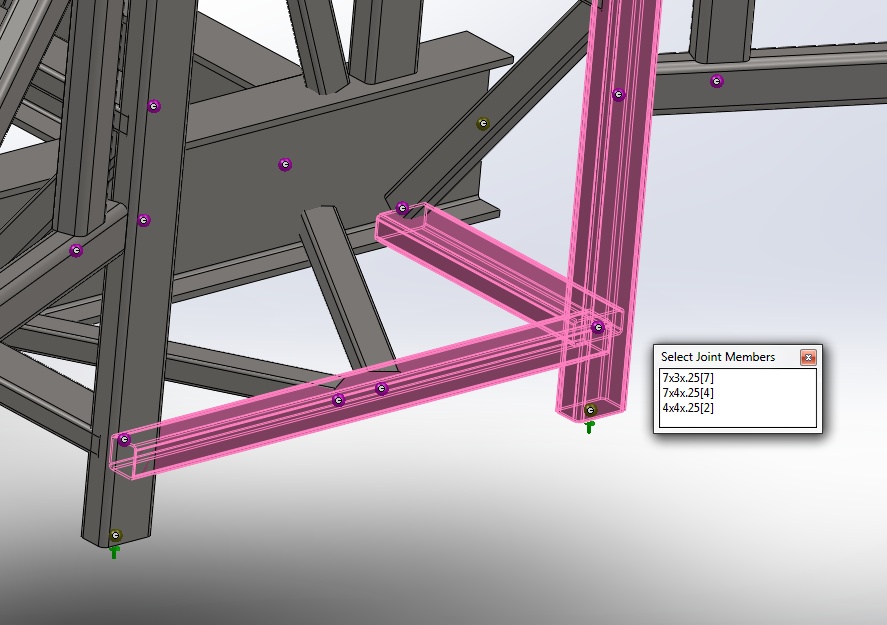

I am running a rather large beam analysis in Solidworks 2012. When creating the joint group, I use zero space between the beams to create a joint, and then edit some of the joints to fix problems. I have also applied a mesh control on some key members.
No errors pop up when I mesh the model, but when I view the mesh, random beam elements have been deleted between joints. These joints are not ones that I have changed, and are not elements I have applied the mesh control to. When I look at the joint group, there are joints attaching the missing elements to the model. Remeshing with different parameters does not solve the issue.
Has anyone seen this before?

Also, applying mesh controls to the dissappearing beams elements does not solve the issue.

this is one i'd work with your reseller on.
