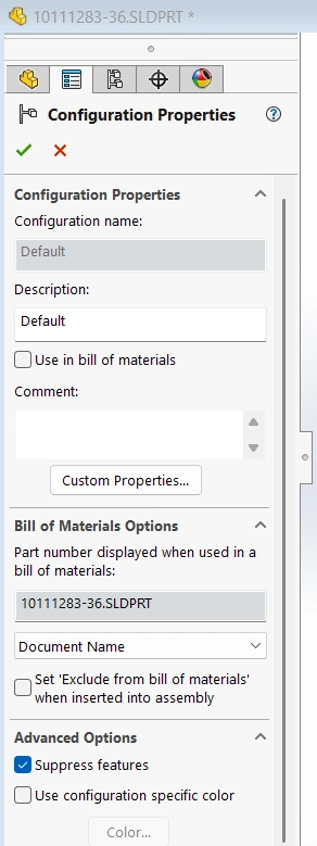

Base configuration from "Default" to "model description"
When creating a new model I want the default 'configuration name' to match the model name.
IE: 10111283-36 should be the configuration name rather than 'default'.
I want to use the configuration name in the title block. When I update the drawing model configuration then the title block will update automatically.

sounds like you need to rename default.
click on default config name hit F2 and rename according to your requirements.
JC
JC 2025-04-29

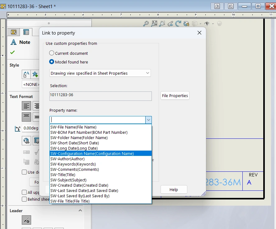

Matthew, there isn't an automatic way to rename the default configuration to the filename short of creating a mcaro you could run that do it. Dou yo ever have more than one configuration?
In the same dialogue you show, you could link the titleblock to the models file name (first in the list).
SG
SG 2025-04-29
I agree with Jason's comment. Why don't you use the model file name in your sheet format?
