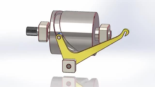

hi fellas, I want to make a barrel cam just like the video I am gonna upload but I can't, I've tried so much but every time there is a problem in it.
here is the file
SolidworksAssemblies

Mahdi,..  I played with doing it and typically use surfaces as paths, in this case, I offset a face from the groove for the center and a point on the cam for the mate.

I was just wondering how I am supposed to make that groove on the surface of the cylindar? With sweep cut or wrap?
If it's sweep cut, how do I find the appropriate curve?

If this is a smooth (even) cut as it appears from the screen shot above, I would use a helix for the route of the swept cut.

Sweeping a rectangle along a helix is not the same as sweeping a cylinder (end mill) along a helix to cut the slot.
I suspect there is probably a reason that Paul didn't present that "solution".

Ah, I see now. I didn't understand what would be different so I replaced the bottom of the rectangle with a radius like using an end mill and it worked just fine. Then I took the time to watch the video and I see he needed it to loop so a helix would not bring it back. The screen shot led me to believe that the slot just went from one end to the other.
I stand corrected, the helix will not work for this problem.

Mahdi,.. so,  to make this work, I added some notes to what I did per the features,.. I created a offset of the cylinder and trimmed away that using your path profile (but converting it using a single curve)  ..the, created a Ruled Surface (this is the path for the ball point)... and/also fixed or used that edge (pierce) for the cut path.  (see attached image and files)

Guys, I really appreciate it for all your help but finally I could make the barrel cam and its lever (I dont know what is the name of that thing in english) as you can see in a couple of posts above, but right now there is another problem I encountered. I want the cylindar rotate with a specific speed and the lever rotate around the pivot just like the movie I uploaded in my first post. I made a motor for rotation and to make the sphere just to go through the groove, I made contact between the sphere and the cylindar and I calculated with Motion analysis but there are two problems:
1- It takes so much time, I just wanted to know whether it is natural or not?
2- After calculating, I see that it is not completely precise and  interferences happen during motion and the sphere does not go through the groove exactly?
I would be so much grateful if anybody helps me.

I don’t design barrel cams but do have a product that has a similar groove. The attached file shows a different approach to making the groove.
The groove is not a perfect representation of the shape you would get with an end mill but is close enough for our purposes.  You can see the imperfection with SurfaceCut3.  3DSketch5 can be dragged around the path to check different locations.
The only way to get accurate groove surfaces would be with the solid tool sweep but it is very limited and doesn’t work most of the time so we use this method instead.
