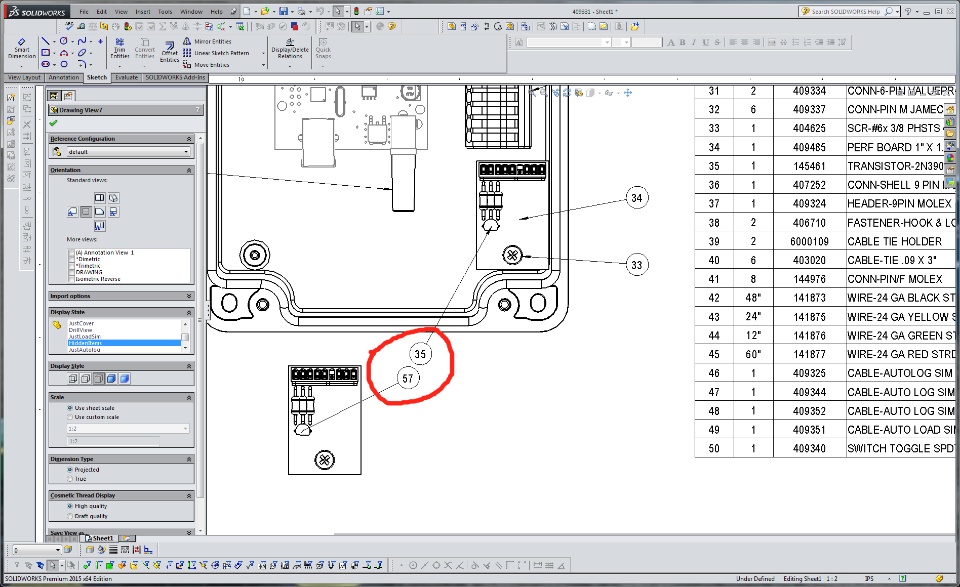

I made a new display view of an assembly showing just one portion of it, and when I went to add balloons I get item numbers different than what they should be. It's acting like I've inserted a different model, but it's the same model from the same directory as everything else. It's not just that part number, it's all part numbers in that new view, I'm just showing one though. I've done this quite a bit before in the past and never seen this before. What I'm I missing here?

It sounds like that view isn't linked to the BOM.  See #12 here:

That fixed it up just fine, but I still wonder why SW decided to do this now. I've done this many times before without a problem. I also see the screw has re-appeared for some reason. Better hide it again.
