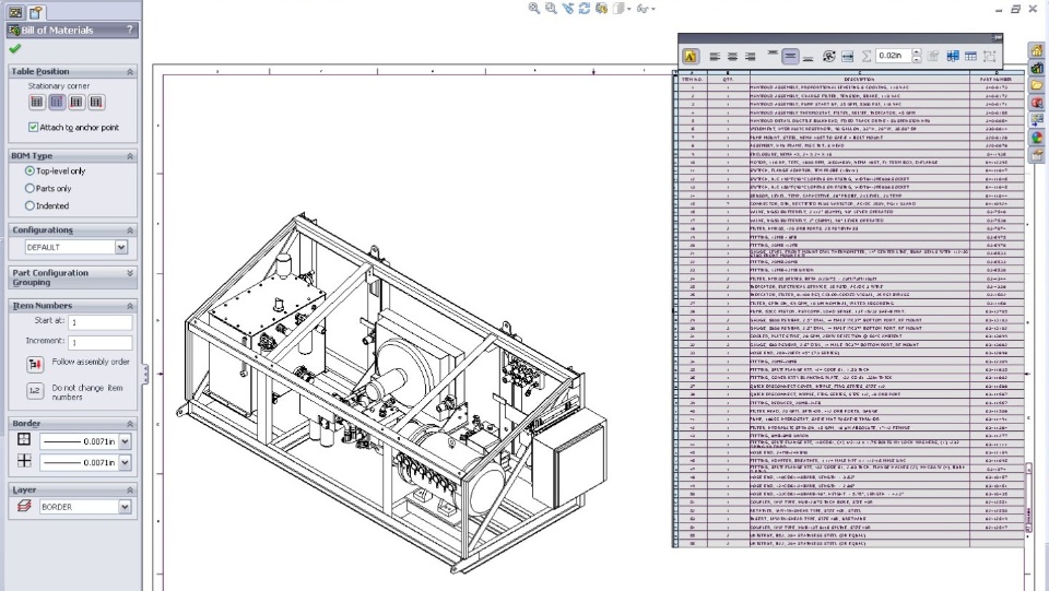

Also, something that doesn't appear in this thread, is that with SW2009 it will load drawings in lightweight mode for SP0-3. You will want to make sure that the drawing is FULLY RESOLVED first, which will probably fix many of the * problems.
SF
SF 2009-09-17

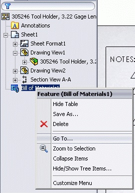

Where is the Part Configuration Grouping tab?  I don't even know if I should be looking at the drawing, the top-level assembly, or sub-assembly.
SF
SF 2009-09-17
At the drawing level highlight the Bill of Materials property manager window and it is the 4th tab down.
SF
SF 2009-09-17
I doubt I'm using the correct terminology, but when I right-click on the Bill of Materials "tree item", the resulting context menu does not list Part Configuration Grouping.  I enclosed a screen capture of what I'm talking about.  Have I misinterpreted what's being referred to as a 'tab', or is Part Configuration Grouping missing?
SF
SF 2009-09-17
To get to this property manager you have to click on the upper left corner of the BOM on the actual sheet not the featuremanager design tree. Hope this helps.
SF
SF 2009-09-17
FOUND IT!
Thank you, John!  The chain around my ankle just released, so I can go to lunch!
Best regards,
Adam

I've the same issue, with SW2012 x64 SP5.  I have a single-level assembly (no subassy's), but do have two configurations.  I made the second config early on, and haven't used/worked on it in a while.  Anyway, I created a dwg of the default config, and the BOM/balloons worked just fine.  I had a hiccup where they arbitrarily changed from Item No. to Part No., but got that lined out.  Now, my issue is I've added a part to the assembly, in the default config, but it balloons as '*'.  The part properties and exclusion level are no different than any other part, and I've tried unchecking the 'suppress new features / components' to see if the assembly style had anything to do with it, but no luck.
I can change the BOM to 'Parts Only' from 'Top-level' and they show up, but why would any new parts not be considered top-level?
I tried to then create a new assy, new dwg with BOM, then add a part to the assy and see if the dwg BOM updated.  It did just fine, like it should.  I tried in both SW2012 & SW2013.  I went back to my assembly/dwg with the issue, and inserted a new BOM and it looked correct.  Deleted the original BOM, the model automatically referenced the new BOM and no more *'s.
Hopefully this will help anyone with a similar issue, as it's stumped me for days and I was just short of scrapping the dwg and starting over - lots of lost work!!
