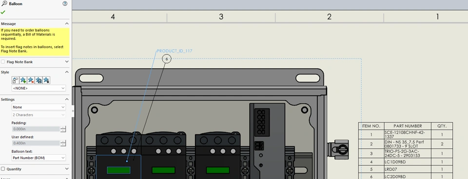

Is there a way to use balloons to call out the subassembly part number instead of the individual component inside the sub assembly?
Example
I have an electrical enclosure that has subassembly LC2D09BD in it, it displays that part number in my bill of material correctly. But when I use a balloon on my drawing, showing the "part number(BOM)", it is showing "PRUDUCT_ID_117" instead of the part number in the BOM.
Answers 1
SD
SD 2025-07-02 Best Answer
For balloon text choose custom properties then from the drop down choose "SW-BOM Part Number".  You can try other properties as well to see what gets you the results you want.
