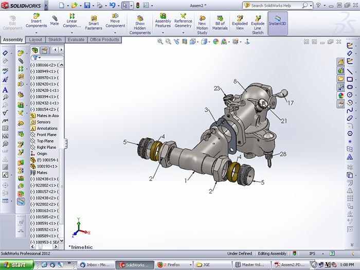

Wondering why on some item numbers. I get a arrow on some items and some do not have arrows.
I dont think you can do this, but I will ask again. When I have ballons in an assembly. I am not able to export that to a pdf document and still be able to rotate it correct?

In your settings it is defined as to the pointer you get when it touches an edge or face. You can RC the arrow and change it.

Is there a setting to make arrows bigger?

That is in your standards and can be changed.

In the ribbon at the top of your screen go to tools, scroll down and go into your options, then click on document properties, click on dimensions, to the right you will see arrows, there you can change the sizes of your arrows to whatever you prefer.
