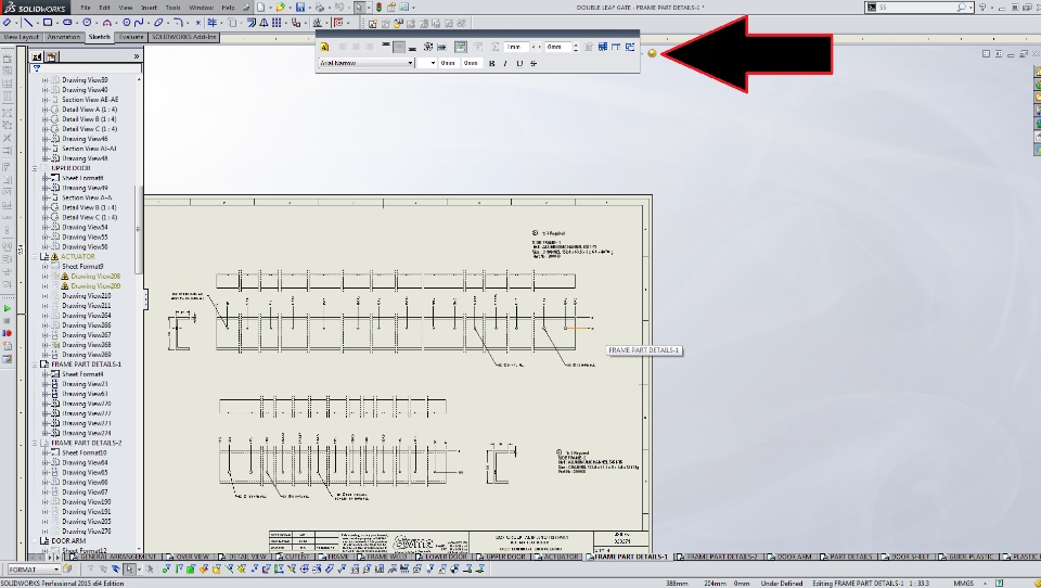

May I please know the name of the Genius who has decided to put this sticky pop up window in front of BOM? It used to be frustrating in previous versions but its even more annoying in 2015! how can I get rid of it, does anyone know?
it doesn't disappear even if you change the sheet! how brilliant is that? thank you

of course I can drag it anywhere but whenever i choose a different cell it relocates again and goes right on top of that selected cell, hence i cant see the rest of the parts. Imagine you wanted to edit a BOM with 100 parts!

John,  the pop-up as a pin that allows you to place it and lock it at any location on your screen.  If you haven't had a chance to use that pin, please try it out.  If you have used that pin, but are still experiencing undesirable behavior, please let me know.

well that pin used to be there in previous versions but I cant find it now and couldn't find anything in the settings to bring the pin back. I am using 2015.
