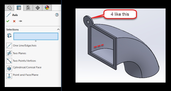

Axis Options
I want to have 4 structures like this for that I wish to use circular pattern tool. Which is the most appropriate axis option for that?

You could pattern the feature in your sketch by using a point rather than an axis. If you are doing a feature pattern I would use the "two planes" option for selecting an axis. select, or create if necessary, two planes that intersect the vertical and horizontal mid-points of the rectangular end face.

You can't really as your circular tab is part of the square flange on the end of your loft. It needs to be a seperate feature or body then you could pattern it using the Point and Face/Plane option from a sketch as below. Or you could pattern the tab within the sketch before creating the feature by finding the centre point of the square/rectangle.

Even if you edit the feature that created that Flange to un-merge it with the rest, and then pattern the body, as ​ suggested, I still don't think you'll like the results.
I'd suggest either adding all four tabs in the original sketch, or have the tab created as a separate body with a separate feature.  Then you could pattern it, and merge the patterned bodies with the rest of the Part.

I used to avoid adding all four tabs in the original sketch because more dimensions and relations have to be used to fully define a sketch. This is the reason I usually do one feature and circular pattern of that feature.
But in this case I can realize that separate feature is necessary to have circular pattern.

In your original sketch - it is easy to divide the area in quarters using one horizontal and one vertical construction line in the center of the rectangle and the drawing the one quarter section, then mirror the sketch, first one way then the other, now everything is within the sketch and no additional features to deal with......

why not just mirror the features??

One sketch and circular pattern to get all four tabs or two times using mirror. Which one is the better option?
BP
BP 2017-04-05
mirror is they way I would go. dont think you will get the results you are looking for with a circular pattern

my solution...
remove the original 0.55 hole.....
mirror that body in Y and merge...
mirror that new body in x and merge...
apply the 0.55 holes after???

Use a linear or sketch pattern.  The circular pattern will go FUBAR if the flange isn't a square.

Using the Mirror sketch function requires very little effort, and certainly less than the way you were trying when you first posted this question.

Best solution if you want to create all these features in one go. The sketch is actually easier, and all the 'extra relations' are all automatically applied from the mirror operations. Change the dimensioned corner and it reflected in all corners. Happy days!
