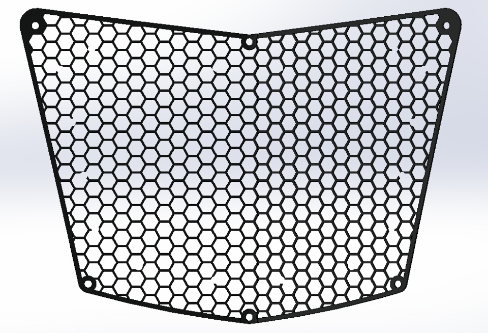

I'm trying to create a grill-type part with a patterned hexagonal feature as shown below. I've tried doing it multiple ways; patterning a sketch, a feature, mirroring variations of both. I still end up with a part that slows down my whole assembly immensely (3-5 min loads). It doesn't help that I'm also trying to put a bend into my part down the center.
Any tips for doing a pattern like this and avoid slowdowns?

Have you tried a Fill Pattern?
Create the hex cut extrude first and a boundary sketch, then the Fill Pattern.
It's limited and you have to experiment with the spacings, but since it's designed for this, it's fairly fast.

Had no clue this existed.. thanks for the heads up. Although I'm worried that this won't solve my issue of long load times.

You might also be able to increase the performance of a feature pattern, decreasing rebuild time, by enabling the 'Geometry Pattern' option. Check out the SOLIDWORKS Blog here for more details -
SolidWorks Geometry Pattern: A Simple Option To Make Patterns Regenerate Faster

Closed and restarted SW to flush, if anything to "flush".
With SW running with no files open, double-clicked this assembly (part above & PEM studs) in Windows Explorer.
Over a network, this loaded in less than a 2 second count.
As you can see in the above image, Fill Pattern says there are 85 holes.
As I said, it's a dedicated command within its operability, so I think it's code has been optimized accordingly.
If you try it, you'll be fiddlin' (or compromising) to get your spacing.
Try a pattern that's about the same number of cuts and see what the time is. If it's acceptable, then it may be worth seeing if the command can do your spacing requirements.

You can create a simplified configuration that suppresses the pattern and use that configuration in your assembly.
If you need to keep the pattern in your assembly for rendering or other reasons, try the freeze bar tool.
This will allow you to lock the features in your part and prevent them from rebuilding/changing in your assembly.
You can also use a speedpack if you want to look into that tool.

The rebuild time definitely improves using this method, but now I'm running into other issues. When trying to get my spacing correct, when I go back to edit the Fill Pattern feature all of my values reset making the process become very redundant.
Oh well.. seems I'm going to be dealing with this pattern rebuild time for now.
