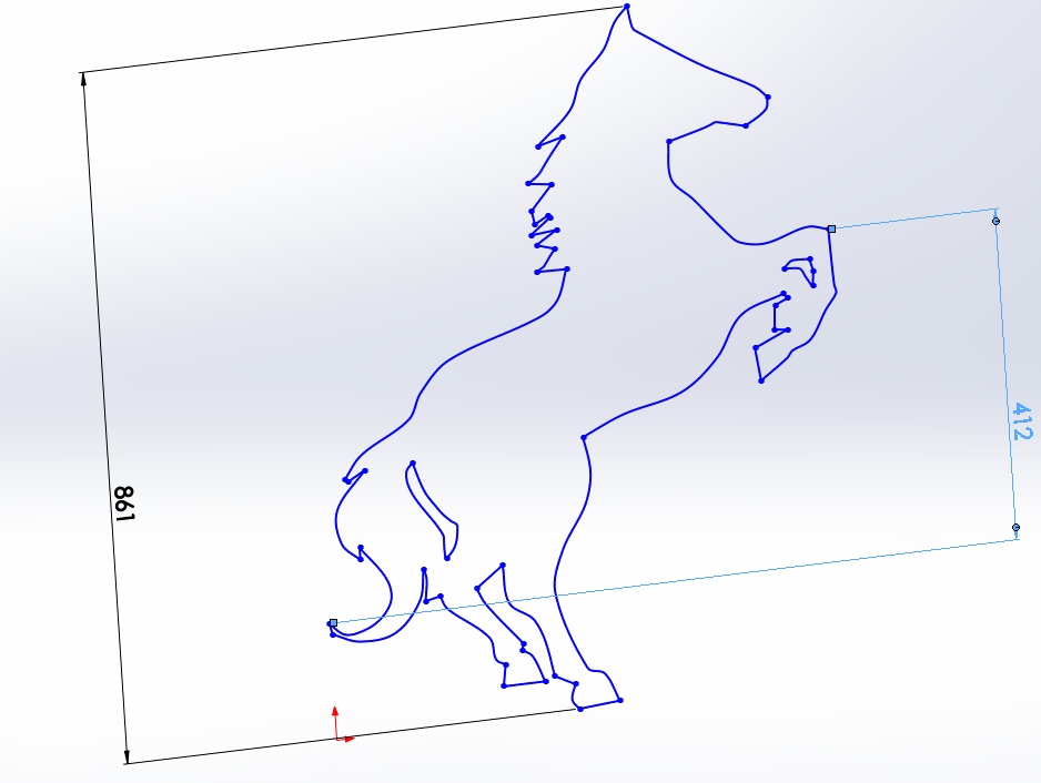

Hello everyone. I have a convoluted sketch deriving from a picture. Is it possible to quote it automatically to get a fully defined sketch? At most I'd like to specify only height and width.
Thank you for your time.
The only way to make it parametric is to add a lot of dimensions and relations, other way would be to make the Sketch Fixed and then change the scale by using the Scale feature after you use the Boss Extrude Feature......
have you tried the "Fully Define Sketch" feature? it is in the Display/Delete Relations drop down on the sketch tab
Hi @Logan Atkins. After I using the "Fully Define Sketch" feature, if I want to change a single dimension, how can I change automatically all other dimensions so that all relationships between dimensions remain unchanged?
you can fully define it like Logan mentioned and maybe create a Block from it that you can easily scale.
i agree with the mentioned ideas. The only practical ways to do what you want is thru creating a block and scaling that or by scaling the part after you have extruded it. The only way to do it exactly how you want is to add equations to try to link the dimensions together..... but that would certainly not be practical. There is no way that i know of to do it with just relations and 2 dimensions.
