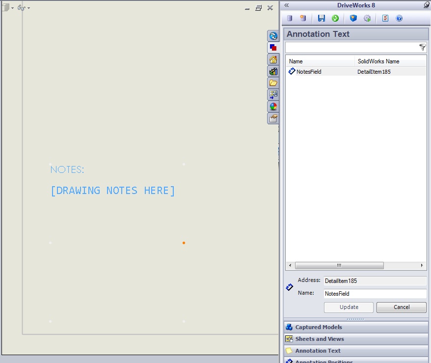

I'm trying to use custom properties to automatically fill in annotations with text generated through design automation in an external program (DriveWorks).
The process is like this:
- I capture a SolidWorks drawing annotation using DriveWorks.

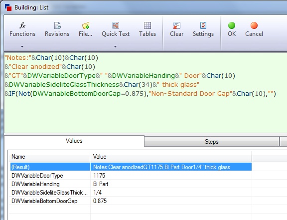

- I use DriveWorks' rule building engine to generate a text string with all of the features that I want to list.
- This text string includes ASCII codes for things like carriage returns, which helps to put each feature on its own line.

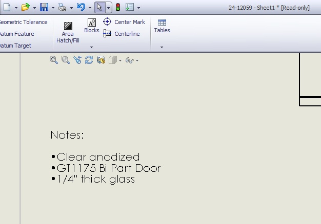

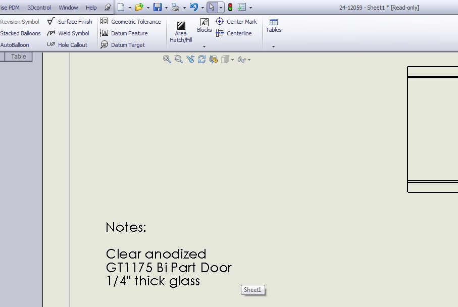

- DriveWorks over-writes the annotation with the resulting text string, which shows up in the drawing:
The cool part is that I can automatically create notes, and space them out over multiple lines. I can even use char(0149) to create bullet points if I want to:
