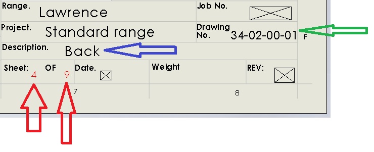

Please look at the image attached to this thread.
Red arrows point at numbers which are automatically inserted into the table by SW.
I would like to do the same for green and blue arrow.
Green should automatically pick up drawing number by filling it with part's file name.
Blue arrow points the space where I would like to have automatic fill in from part description.
Is it possible to do that (insert equation like in BoM table?)?

Edit your drawing templates, place a note on the desired position and link the note to part properties.

Thanks a lot!
Exactly what I've been looking for:)
