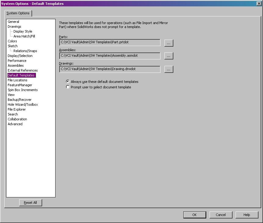

I have run into this when the Default Templates are still set with the old names and paths even if the old files have been removed.  This is different than the default file locations.  To fix it make sure that on every computer you have running SolidWorks you look at the System Options tab for "Default Templates."  Assign your custom files for part, assembly, and drawing.  See the attached screen shot.

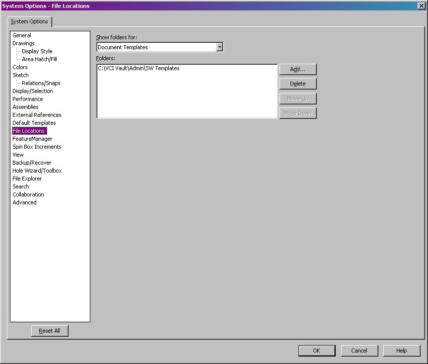

I would also recommend putting your custom templates in a different folder than the default one created by SolidWorks, and then on the System Options tab for "File Locations" linking to your custom folder and completely removing the link to the SolidWorks-created folder.  We have ours in our vault, but before we had a vault we had a folder on the network drive with the templates (and sheet formats) in it so that everyone in the company could access them.  In the second screen shot you can see I only have the link to my vault folder and nothing to the original SW folder.

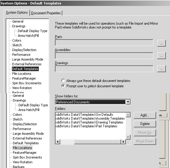

As shown above, the default file locations point to the custom file locations. The SolidWorks files seem to pop up out of the blue automatically in these custom file locations. I have put them in their own folder as you can see from the file location list. Ideally I want to get rid of them altogether. I do find that they get selected on occasions when doing routing even though I have specified a custom default routing file template.

     What your doing, and Wayne's reply above are what I've done since the function was introduced (2k1 ?).  Anyway yes I've always setup ours like you've shown and added a "SW Default" folder also.  For some reason I move it to the top of the order in file locations where it seems to behave best, I.e. the SW defaults don't get propagated into "my" template folders.  Not sure why this has never been addresses by SW as an option to disable.  So yes if you delete them etc. they will always reappear.

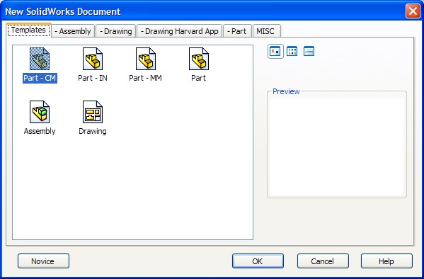

Template organization is easy and can be revision proof.
Chose a folder location that will not be effected by the next SWX install. For me, I have a drive set up with just my data on it. My templates reside on that drive. So, something like this.
E:/CAD
I then have a template specific folder: E:CAD/Templates
I’ll point my file locations in SWX (As demonstrated above) to that folder.
Each sub-folder in the “Templates” folder will then show up as a tab in the “New SolidWorks Document” window.
See screen shot.
When not on a particular client engagement, I’ll move clients templates to a folder called “Templates – Inactive” and move it back to the “Templates” folder when I am doing work for that client.
