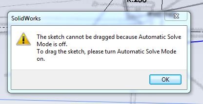

I must have fat fangered something. Now I'm going crazy because I can't drag my sketch entities around.
The "SolidWorks Help" wasn't very useful.

Tools > Sketch Settings and uncheck Automatic Solve

Apparently SolidWorks does not find this a concern. Sure we all know how to turn it on but it doesn't work that easy or should I say that it doesn't work. I am working on the Pre-release 2014 and never had this problem until now and have wasted countless hours trying to work around this but am unsuccessful. What is the function of this and why is it that all of a sudden this Automatic Solve Mode shows up making sketches on drawings useless.
Oh, I almost forgot. the reason I am sketching on the drawings is because the crosshatching does not work correctly in which I have to create a sketch to make a boundary.

Why does the program decide to randomly do this? Just started a new session for the day and it decides to do this. Such a great program, but so many bugs.
This doesn't work if you also have a "Converted view to sketch" on the same sheet. It seems to interfere with the live view "Auto Solve". It won't toggle off.
I am with Franklin, why does SW have this stupid function? Does anyone use it?
I can't drag my sketched lines around with it on or off.
It tells me to turn it off, and I did, but it still shows the same error message.
it remains the same problem even after checked off the option, my solidworks c/w epdm.
