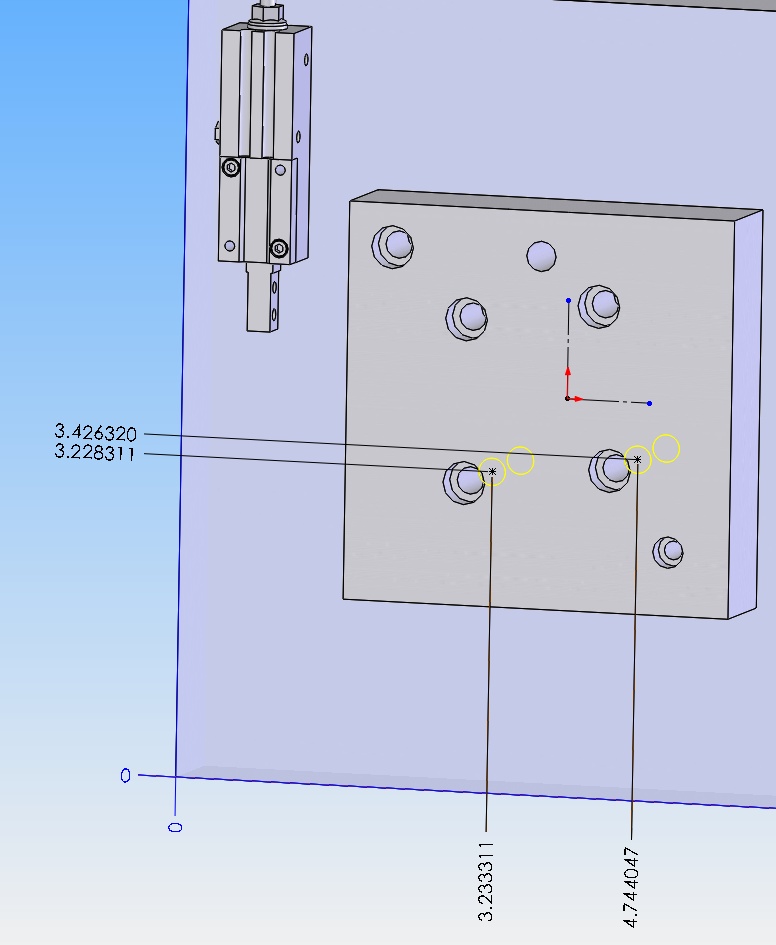

AutoDimension2 not working correctly editing sketch in context
I have a sketch that I am editing in context.  I am trying to place dimensions on the sketch automatically.  I first create two lines, one vertical, one horizontal, based on the origin.  I then use those lines as my horizontal and vertical datums for the autodimension2 function.  It will not work!  It keeps dimensioning to the edges of the part.  What am I doing wrong!?

this is what I get:
