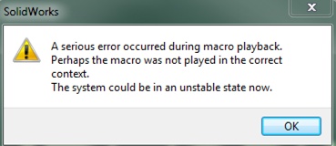

I am trying to auto-run an embedded macro as shown here:
http://www.cadsharp.com/blog/equation-triggered-macros/
The macro is used to modify design table values based on custom property inputs. The macro runs and updates the design table as needed however I get the following error (see below). Also sometimes I may get a corrupted design table. The macro I am running is shown below and only runs when the RunMacro custom property is 0. Attached is a simplied version of what I am trying to do however the premise is the same.
Sub main()
Dim valOut   As String
Dim resolvedValOut      As String
Dim swApp As SldWorks.SldWorks
Dim swModel As SldWorks.ModelDoc2
Dim swDesignTable As SldWorks.DesignTable
Dim CellValue As String
Dim boolstatus As Boolean
Set swModel = swApp.ActiveDoc
Set swCustPropMgr = swModel.Extension.CustomPropertyManager("")
'RebuildMacro Variable Used to Only run code on first rebuild
swCustPropMgr.Get2 "RebuildMacro", valOut, resolvedValOut
MacroRunValue = valOut
'Get Length Width Height
swCustPropMgr.Get2 "LENGTH", valOut, resolvedValOut
Length = valOut
swCustPropMgr.Get2 "WIDTH", valOut, resolvedValOut
Width1 = valOut
swCustPropMgr.Get2 "HEIGHT", valOut, resolvedValOut
Height = valOut
'If the model is rebuilt for the first time (MacroRunValue = 0)
If MacroRunValue = 0 Then
'Get Design Table
Set swDesignTable = swModel.GetDesignTable
'Edit Design Table
swDesignTable.EditTable
'Changes the first data row second colum to the cell value
swDesignTable.SetEntryValue 1, 0, False, Length
swDesignTable.SetEntryValue 1, 1, False, Width1
swDesignTable.SetEntryValue 1, 2, False, Height
'Update Design Table
boolstatus = swDesignTable.UpdateTable(SwConst.swDesignTableUpdateOptions_e.swUpdateDesignTableAll, True)
'Set RebuildMacro Custom Property to 1 so macro does not run again
swCustPropMgr.Set "RebuildMacro", 1
End If
End Sub
