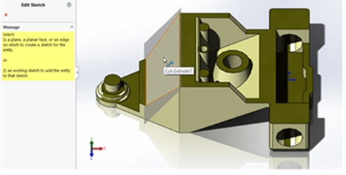

Original View before getting in the sketch mode:
Normal view in the sketch mode:
