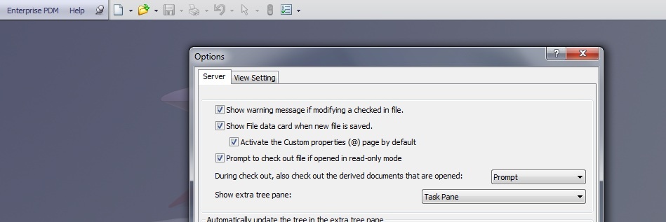

If you want to remind users to check out a file while opening you can configure to give an warning message under. SolidWorks > EPDM > Options > Check the prompt to check out the file if opened in read-only mode

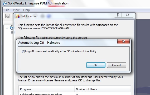

Automatic Log-in: If you  disable this setting as shown in the picture the user may not be asked to log-in. But if there is an inactivity for a very long time it might ask to log-in.
