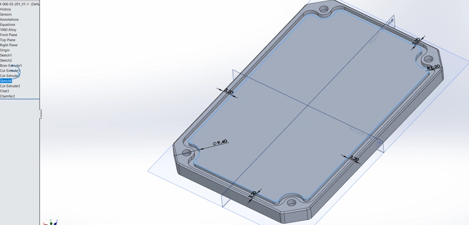

I will sometimes create a curve that has dimensions, then use those curve edges to create another curve that I use to create an extrusion and or cut.
When creating the drawing, I want to show the initial sketch dimension that is driving the actual extrusion. When I select the sketch to show its dimensions, nothing is showing. How can I show a sketch's dimensions in a drawing view?
when I pick the sketch in the drawing to add the dimensions, it comes back no dimensions added. Can SW do this, if not auto dimensioning is pretrty pointless

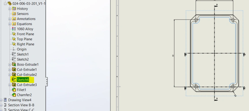

"Insert > Model Items, set the Source as Selected Feature then you should be able to pick your sketch from the tree and have the dims come in." In SW2023, I don't see how to select the sketch in the tree as I don't see a tree While in Insert>Model Items. Did you mean pick in the tree before Model items?
But along the same line of thinking, with View>Hide/Show>Sketches turned on, preselect one sketch element and then select Insert>Models (with Selected feature chosen).
